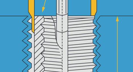

We offer a limited selection of UNF, UNC, and metric threads for machining along with coil and key inserts (but do not supply or install the inserts). On both milled and turned parts, threaded holes must be modeled at the proper diameter, however, threading options differ for milled and turned parts. Automatic external threads are not available for milling at this time. It is possible to machine approximate external threads using ball and flat end mills if threads are modeled and are at least ½-13 (M12) or larger. Threaded holes on turned parts are also available and external threads are offered on the axial diameters. Simply model the nominal diameter; do not model the threads.

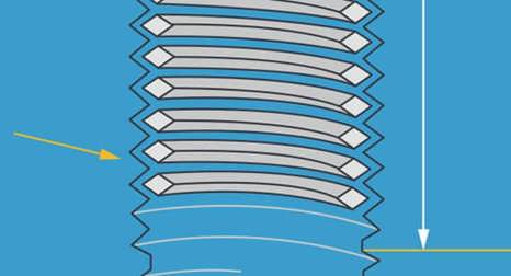

Example 1:
This is a cross-section view of a through hole that is threaded from one side. In this case, the hole depth exceeds the reach of the tool. The result is an unthreaded section that is opposite the side selected.

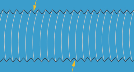

Example 2:
This is a cross-section view of a through hole that is threaded from one side. In this case, the hole depth does not exceed the reach of the tool. The result is the threads will be formed across the entire length of the hole.

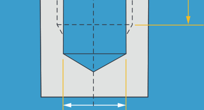

Example 6:
A designer may add a point at the bottom of a blind hole. In most cases, this represents the point left if a pilot hole is drilled with a drill bit. It may also serve a function to their design, or provide an area for chips that are generated during the threading process to fall. If this point is added to the model, the threading will stop roughly 0.010 in. above the start of the point angle.
