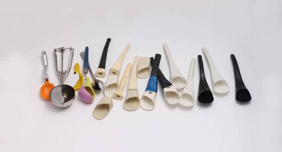

After creating a few prototype ideas and eliminating the lid concept, the design process led to a unique idea of a spoon with a deep capacity. Grant took two examples of the most successful designs away to test over the Christmas holidays and was able to eat Chinese food, cereal and banana fritters for the first time with next to no spillage. Spurred on by this success, the team turned to Kickstarter to raise sufficient funds to turn the prototypes into a commercially available product, quickly garnering £16,000 of support from just four generous donors.

The various options that led to the final design

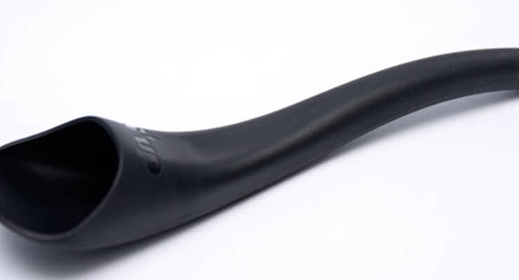

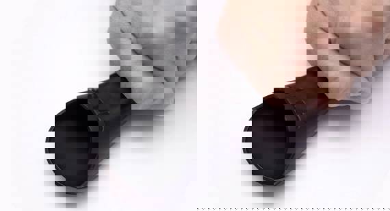

S'up Spoon final version
