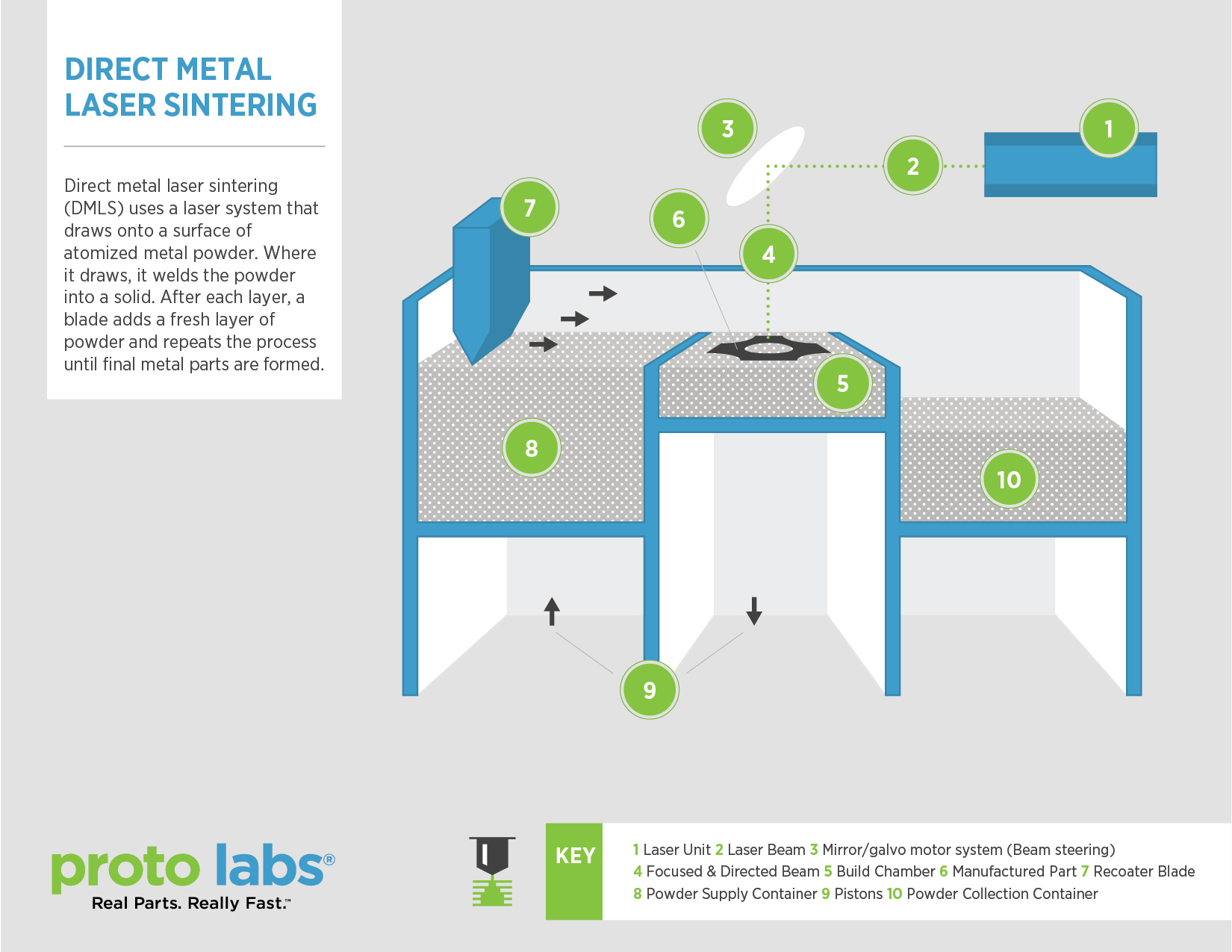

But DMLS does require a shift in design thinking. “You have to think about it differently at the design phase,” says Lynch. One of the biggest adjustments is how to adapt to the introduction of internal stresses during the build process. “You are taking a room temperature metal powder, applying heat for an instant melt, followed by rapid cooling,” he explains. The rapid change causes stress at each layer of  during the build process. “The part tries to curl upwards as it is building.”
DMLS Process infographic
The ways to minimize these unwanted effects involve identifying a part orientation that will yield most consistent cross-sectional surface area throughout the build process (deciding how the part is positioned during various phases of the build), and introducing structural supports that are created along with the part during the build.
Lynch also explains that after build, each part goes through a stress relief cycle in a furnace. This is to avoid warping of the parts after they are removed from the structural supports and build plate. When creating the build plan, one also has to consider how supports will be removed. “We have to orient parts in a way that allow support removal by hand tools, or secondary machining.”
