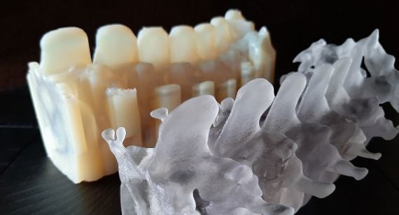

Before and after support removal for PolyJet part
In the past, inefficient post-printing has been a challenge for PolyJet additive technology. Those challenges have now been solved by automated software from PostProcess Technologies, as seen here in this before and after support-removal example.

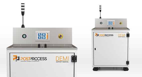

A digital approach from my company, PostProcess Technologies, brings the benefits of automated additive post-printing to the forefront. A software-controlled interface with extensive process monitoring and preventative maintenance offers one-button program selection for the operator to enable ease of use and repeatability. Since the system is run by programming and can process many parts at once, the outcome is an entire batch finished the same way every time. Additionally, precision software control of the machine’s energy output results in minimal damaged parts, so there is less scrap and therefore less reprinting.
Post-3D printing automation
PostProcess Technologies' automated DEMI Support Removal machine brings the benefits of automated post-printing to PolyJet additive manufacturing.

So what does an automated approach actually yield? Protolabs’ previous process on a typical day’s worth of finishing 90 parts would require about eight hours of manual labor plus four hours of soaking, for a total cycle time of 12 hours. In one week, that’s 40 hours of labor required to finish PolyJet parts one by one.
Our PostProcess software-based platform reduces labor time by 50% for these same 90 parts to just four hours, freeing up 20 valuable labor hours per week. Using skilled labor for more meaningful activities while supporting the need for a socially distanced manufacturing floor is why an automated solution makes sense. Additionally, overall cycle time with PostProcess software is reduced from 12 hours to eight hours, which helps get more parts finished faster. This time savings means more cycles can be run throughout the week, supporting Protolabs’ commitment to accelerate its customers’ speed to market.
