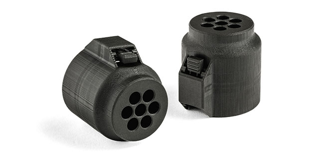

clear 3d printed part

Shown below is a Carbon DLS part built with RPU 70 Rigid Polyurethane in normal resolution (0.004 in.).
natural finish on black dls part
Unfinished
With unfinished, you get varying aesthetics based on build orientation. Dots or standing nibs remain evident on the bottom of the part from the support structure remnants.
Natural Finish
With natural finishing, you get varying aesthetics based on build orientation. Standing nibs are sanded flat.
