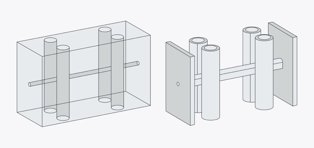

Draw: Part Volume
Part volume is a common factor that can drive the price up unnecessarily. The consideration should be your overall part volume and how much of that volume is critical to fit, form, or function. Below is a 5 in. x 2 in. x 3 in. (127mm x 50.8mm x 76.2mm) block where the critical features are channels. The ends of the part are also important because they help align the part in the assembly. This part is very high volume, but not all of that volume is critical to the function of the part. On the revised version, the channels are maintained as well as either end of the part. However, the rest of the material boxing in the channels has been removed, leaving about 0.1 in. of wall thickness for the channels. This reduces the part volume by 80% and can reduce the cost of the part by 50-60% depending on technology.
Part Rendering
During the design phase, removing material that isn't necessary can often maintain strength, but it's also likely to speed up your build times.

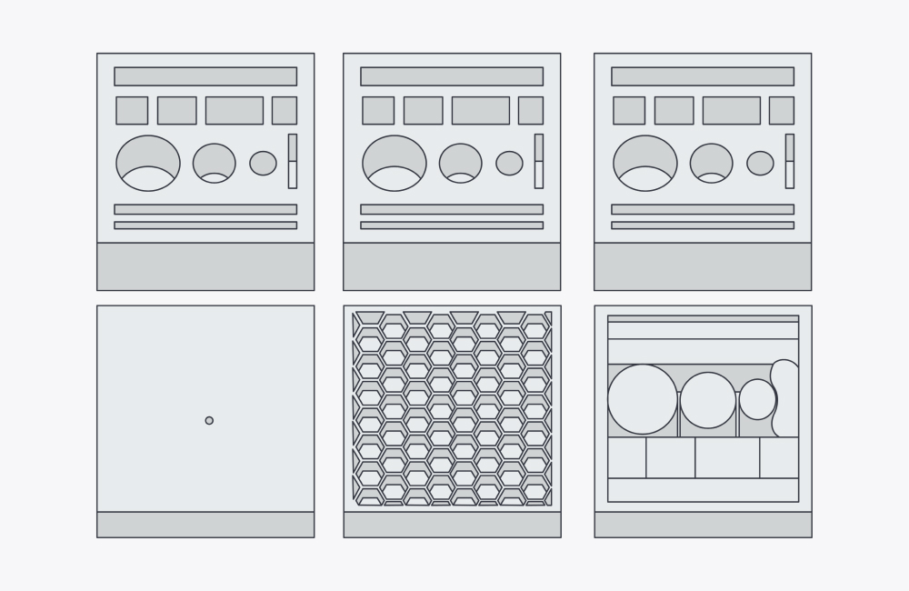

Another way to reduce material volume is to shell the part. This is best suited to selective laser sintering (SLS) and Multi Jet Fusion (MJF) since these do not require support structures. Additionally, since these processes see more heat than the other additive technologies, reducing volume will result in a higher quality part, because it avoids dimensional inaccuracies caused by material shrinkage. Below is an example of a 4 in. x 4 in. x 2 in. (101.6mm x 101.6mm x 50.8mm) organizer tray. The original model is very highvolume. The other two versions show different ways to reduce material.
The first method is to use ribs or honeycombs to maintain the structure and rigidity of the part, but also to remove any excess material. This method reduces the volume by 30% and reduces the cost by 20%.
If the rigidity of the part is less critical, you can hollow out the part instead. For this example part in the third column, hollowing reduces the volume by 36% and reduces the cost by 26%. Note that material should be reduced in a way that keeps the geometry open, to allow for complete removal of unsintered/unfused powder after the build. Sealed off cavities should be avoided.
part rendering
As noted above, hollowing out your part, as indicated in the third column images, can speed production times and also offer a way to remove unused metal or plastic powder.

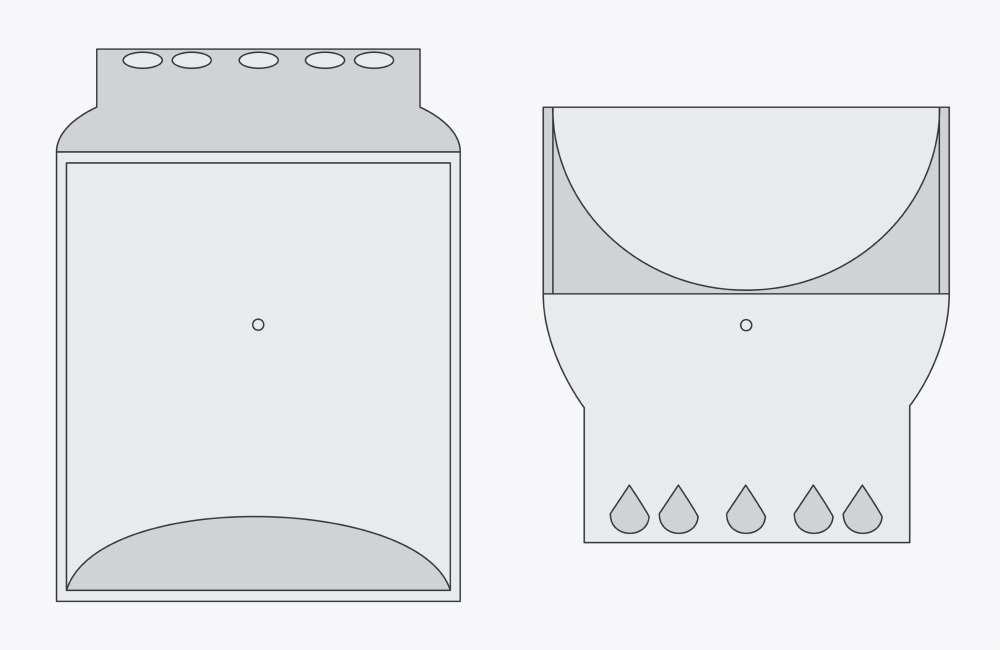

Recoat: Part Orientation
Recoat time is the second factor that drives build time and therefore cost. The recoat time is driven by the height of the build, but this isn’t necessarily based on the extents of the part. The build height is based on the height of the part in its optimal orientation. The optimal orientation will vary based on geometry, but generally, if the part can be designed to build in a shorter orientation it will be less expensive. You see this especially with stereolithography (SLA) and direct metal laser sintering (DMLS) since these technologies use support structure, which plays a significant role in choosing build orientation.
Here's a part that needs to be built in metal using DMLS. The first design iteration has channels that are too wide to build horizontally without requiring internal supports that will be trapped inside. However, changing the cross section of the channels to a self-supporting tear drop shape allows the part to build in the shorter, second orientation below. This small change reduces the cost by 18%.
part rendering
Changes in print orientation can help you choose alternative channel shapes, potentially speeding build times.
