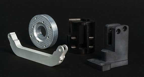

Understanding Anodising
Anodising is primarily known for its treatment of aluminium alloys, however, that doesn’t rule out other metals, such as titanium, which is also suitable for anodising.
The process combines part immersion and electrical currents and results in the creation of a protective oxide layer. To put it simply, imagine your aluminium part taking a tip in a bath. The bath is filled with electrolytes and with the support of an electrical current an oxide layer forms on the part. This oxide layer provides your part with reliable protection from corrosion.
How it works
- Part is cleaned and rid of contaminants.
- One end of the part connects to the positive terminal (making it an anode).
- Part is dipped into acidic electrolyte solution.
- A separate electrode takes on the role of the cathode.
- The electrical current is introduced.
- Metal ions interact with the oxygen ions.
- A protective oxide layer is formed on the metals surface.
Imagine your part emerges wearing a self-healing, corrosive resistant armour.
Benefits of Anodising
Anodising brings with it a multitude of advantages, from heightened corrosion resistance and durability to a variety of aesthetic options.
you want a part with increased resistance to abrasion? A lower coefficient of friction? And/or vibrant colours? Anodising might be an option for you.
Here is a breakdown of the key benefits anodising provides,
- Corrosion Resistance of course right at the top of the list is corrosion resistance. The oxide layer that anodising produces shields the metal part from environmental factors.
- Enhanced Durability Not only does the oxide layer provide wear-resistance but also improved hardness. Naturally extending the lifespan of metal parts.
- Aesthetic Options make it perfect for decorative applications, allowing you to play with the colour of your part.
- Lower Coefficient of Friction allowing for smoother sliding, reduced wear, and improved efficiency.
- Electrical Insulation is ideal for electronic applications, anodising aluminium displays electrical insulating properties.
- Lightweighting makes it perfect for weight-critical applications in industries such as aerospace.
- Thermal Insulation is offered to a degree by anodised aluminium, thanks to its oxide layer.
