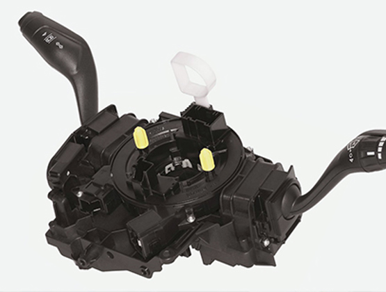

Part made with Protolabs custom injection moulding services at Protolabs Learn More

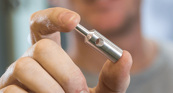

Part made using Protolabs custom CNC machining services at Protolabs Learn More

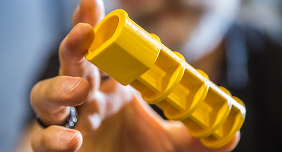

Part made using Protolabs custom 3D printing services Learn More
