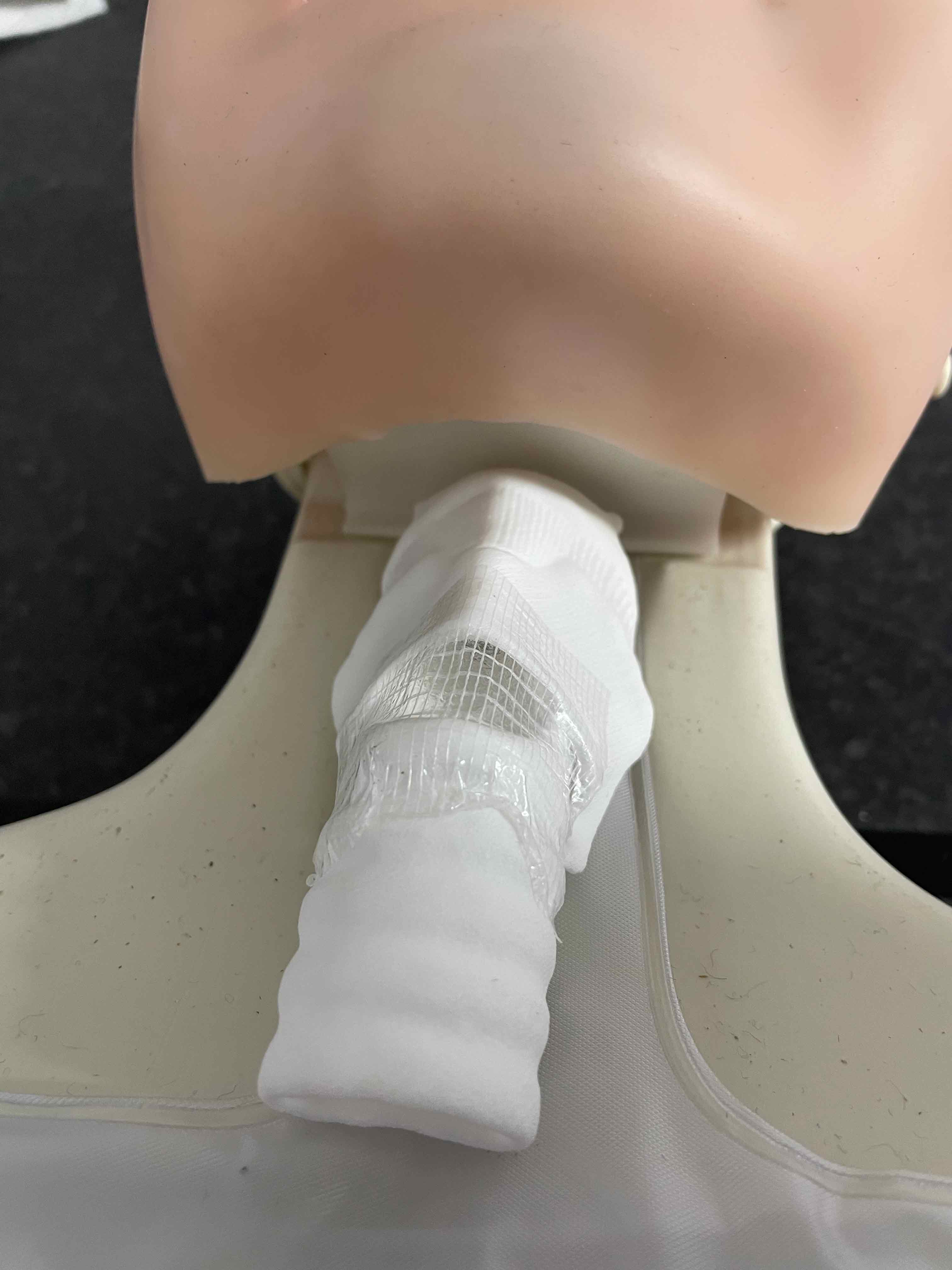

Altogether, 16 parts were manufactured – tube-shaped replicas of the human trachea that are inserted in the specific anatomical location under the heads of the life-saving training manikins.
These trachea models contain a window that is covered by duct tape. The tape simulates the amount of pressure required for a scalpel to make an incision and replicates the sound of cutting into the cricothyroid membrane in a real life. On top of the tape, packing foam is layered, mimicking the fatty layer under the skin, and over this goes imitation skin – a product used by tattoo artists to practice on and innovatively sourced by Tony to create his new and improved tool for medical professionals. This fake skin is malleable and can be manipulated just like real skin, allowing students to feel the structure underneath the skin of the manikin ‘patient’ and find the correct area to make an incision.
To further enhance the authenticity of the training, Tony inventively added a connective tube to the bottom of the part created by Protolabs and inserted it into the lung bag of the dummy, so practitioners can now ‘breathe’ for the patient, thus making the training scenario feel very real indeed.
