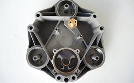

Metal 3D Printing (DMLS) Design Guidelines and Capabilities
Metal 3D printed part made using DMLS

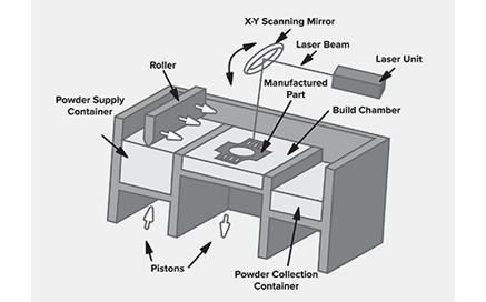

How does Metal 3D Printing Work?
Direct Metal Laser Sintering Process
The components of a DMLS 3D printer include: laser unit (1), laser beam (2), mirror/galvo motor system, beam steering (3), focused & directed beam (4), build chamber (5), manufactured part (6), recoater blade (7), powder supply container (8), pistons (9), and powder collection container (10).
The DMLS machine begins begins the 3d metal printing process by sintering each layer—first the support structures to the base plate, then the part itself—with a laser aimed onto a bed of metallic powder. After a cross-section layer of powder is micro-welded, the build platform shifts down and a recoater blade moves across the platform to deposit the next layer of powder into an inert build chamber. The process is repeated layer by layer until the build is complete.

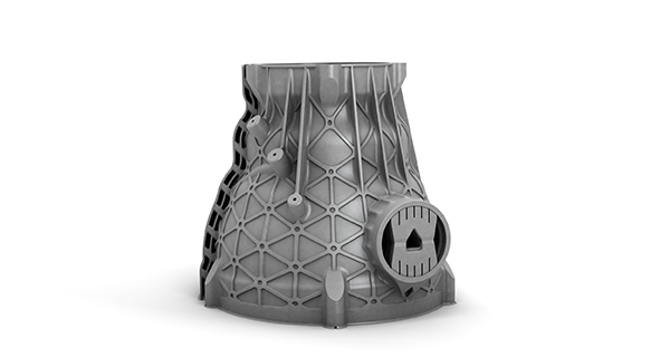

Metal 3D Printing Design Considerations
  • Ensuring parts are supported properly during the build process, or avoiding exceptionally difficult build shapes will help avoid warping and curl
  • Minimum allowable unsupported bridge distance is 2mm
  • Walls below 1mm must have a wall height-to-thickness ratio of less than 40:1 or the structure may fall apart.
  • Thick walls are wasteful and inefficient, best to hollow these with a honeycomb or lattice structure - this will reduce cost whilst preserving structural integrity
  • Tree-like structures, gentle twisting seashell curves, and other organic shapes are all cost-effective
  • Consider DMLS for highly complex structures, which are difficult to machine
  • Standard DMLS parts will have a finish similar to that of a sand casting. If requiring smoother finishes there are a number of finishing operations available including bead blasting, painting and 3D post-machining
  • Metal sintered parts are 99% as dense as conventionally formed metal materials
  • Multi-part assemblies can be greatly simplified using DMLS
  • Stair-stepping will occur on angled surfaces, a pyramid shaped part would have rougher surfaces than a cube
  • Extra material should be considered when close tolerance holes or features are required - for reaming or secondary machining
