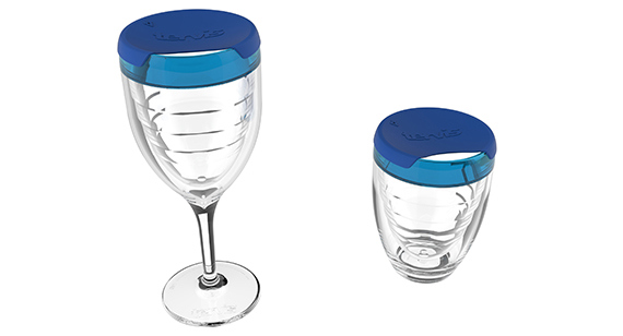

Underside of Tervis Tumbler Cover
Here is a view of the underside of the cover. Tervis Tumbler turned to Protolabs’ injection moulding service for help with rapid prototyping and final-part manufacturing for the covers to Tervis’ popular plastic wine glasses.
