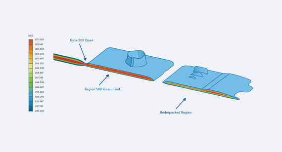

open gate illustration
In this illustration, the gate is still open along with two sections: the region that is still pressurised and the underpacked region.
In order to counteract this shrinkage as the plastic cools and solidifies, pressure must be applied to compensate.
Hold pressure is used to force more plastic material into the mould cavity to increase the density of the moulded part. This helps prevent volumetric shrinkage-driven issues such as sinks and voids.

Determining optimum hold pressure involves identifying the lowest amount of packing pressure to adequately fill the remainder of the mould cavity that was intentionally left short during the filling phase, and reduce any shrinkage related issues to an acceptable level.
Then, the highest acceptable packing pressure is also identified by finding the pressure in which the mould begins to flash, or other issues arise with the part, such as the part sticking upon ejection. These points—the lowest and highest—establish the acceptable packing pressure window for a specific melt temperature.
well packed region
Part geometry here shows a well-packed region, a region with high potential for being underpacked, and a thin section that freezes early, isolating thicker regions from hold pressure.
Selecting a point two thirds of the way between these points provides for a setting that will effectively pack the part, while minimising overpacking issues [see illustrations].

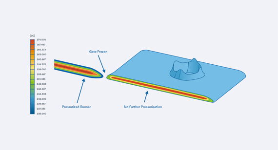

gate freeze
In this illustration, the part weight continues to increase as more hold time is used, until gate freeze. Once the gate is frozen, the part weight doesn’t increase because plastic is no longer flowing through the gate into the part. This is what leads to consistency and process robustness.
Following standard practices for injection moulding part and mould design, it is common that gates will be placed in an area that allows for thick to thin packing, and the gates are typically sized as a percentage of the wall thickness being gated into.
Common gate sizes typically range from 60% to 80% of the wall thickness, but certain gate designs require more restrictive sizes to facilitate separation from the part wall.
Given that the gate is typically thinner than the part wall, the gate will solidify before the part geometry. Once the gate is solidified, pressurisation of the part cavity from the feed system is complete.
There is no need to continue applying packing pressure once the gate is frozen, as this will only pack out the feed system.

Once part weights reach a stable level, it can be inferred that the gate has frozen, and the parts are no longer being packed. The hold time where the weights have leveled off can be considered the time for gate freeze.
Typically a buffer of one to two seconds is added to the hold time setting to ensure that the gate is frozen regardless of any inherent variation within the material or machine.
In the Gate Freeze chart, it can be seen that the part weight continued to increase as more hold time was used. As the gate began to solidify to a larger extent, the rate of weight gain begins to slow.
In this example, five seconds is the first point where the weight has stabilised. This indicates that the gate has frozen somewhere between four and five seconds, and a one-second buffer has been added to ensure process robustness.
