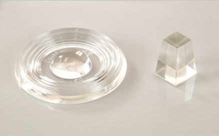

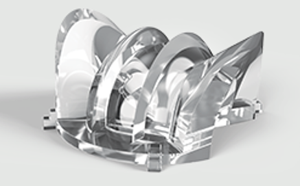

There are two distinct types of LSR available, one of which is opaque and another that’s see-through. This optical-grade LSR is second only to glass when it comes to transparency, and suitable for use in the food industry.
