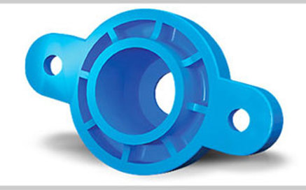

Nylon Injection Moulding
Moulded nylon parts provide high strength, temperature, and chemical resistance
Our Nylon Capacities for Injection Moulding
| There are many types of moulded nylon materials, each with its own advantages. For example, nylon 6/6, offers great hardness, stiffness, and abrasion resistance, while nylon 6 is extremely hard and tough at low temperatures. |
