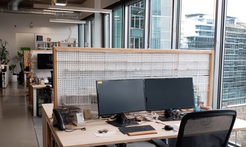

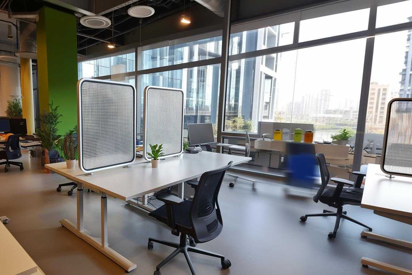

Metasonixx was born from this vision. Instead of relying on traditional soundproofing materials, the company developed acoustic metamaterials: panels that use the physics of sound itself to cancel unwanted noise. Lightweight, transparent, and reconfigurable, these easy-to-move dividers are designed to improve concentration and privacy without blocking light or isolating people.

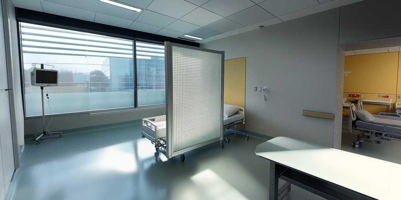

Initially, most demand came from customers in industrial spaces where intense noise needed to be mitigated constantly. Thanks to Protolabs, it was possible to make the panels modular, allowing the final shape to be rearranged to suit different situations. Today, Metasonixx products are being adopted across industries. In open-plan offices, they allow employees to concentrate without cutting off visibility. In schools, teachers can mark assignments faster with fewer distractions. Hospitals benefit from their lightweight, moisture-resistant design. Customers range from Chevron and Autostrade per l’Italia to educational institutions and healthcare providers. Collaborations with distributors like STS Isolamenti in Italy have also provided access to manufacturers of luxury products.
