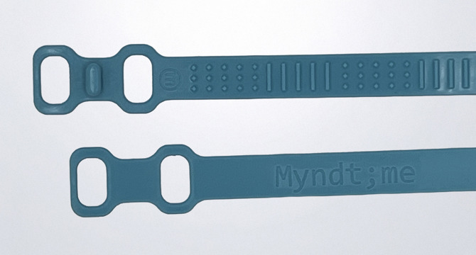

As a lifelong inventor and problem-solver, Patricia Porter wanted to design something discreet that people could use at any time without drawing attention. The result was a wearable silicone band with built-in tactile features — from textured ridges to a subtle “pop” element — giving users an easy way to calm their minds and refocus.

Protolabs first collaborated with Myndtime to create a prototype, demonstrating how the concept could take physical form across various manufacturing methods, with the reassurance that the CAD file was optimised and manufacturable. Material choice was equally important. Protolabs recommended FDA-approved, food-grade silicone: a durable, flexible, and skin-safe option commonly used in wearables.

The project gathered momentum and investor support, but cost efficiency remained a key priority, so Protolabs Network introduced a new approach: compression moulding. By embracing the Protolabs Network, Myndtime were able to access a wealth of additional capabilities, including compression moulding, which cut costs by around 50% compared to traditional injection moulding, making the project viable for production. The mould design also allowed for interchangeable inserts, enabling multiple variations and colourways without the need for costly new tools. This flexibility complements Patricia’s vision for the product, where she has strong demand from corporate buyers for customised, branded versions of the wearable band to roll out across their organisation to boost well-being.
