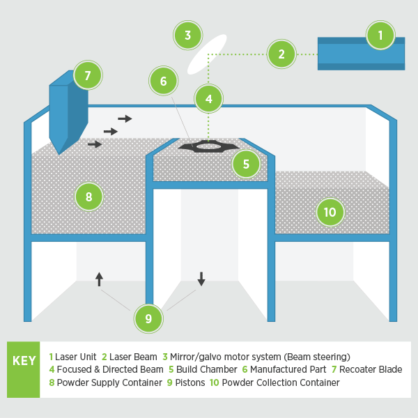

DMLS works by slicing part models into paper thin layers and then “drawing” them with a laser in a bed of powdered aluminium, Inconel, titanium, stainless steel, cobalt chrome, and other metals. Starting from the bottom layer and working up, each metal particle is melted and fused to its neighbours, one layer at a time until the part is complete. The result is a fully dense metal product with mechanical strength and fatigue characteristics little different than—and in some cases exceeding—one machined from comparable wrought, forged, or cast material, but produced with minimal tooling costs, significantly reduced setup times, and little waste.
This illustration shows the direct metal laser sintering (DMLS) process that fuses powder to form fully dense metal parts.

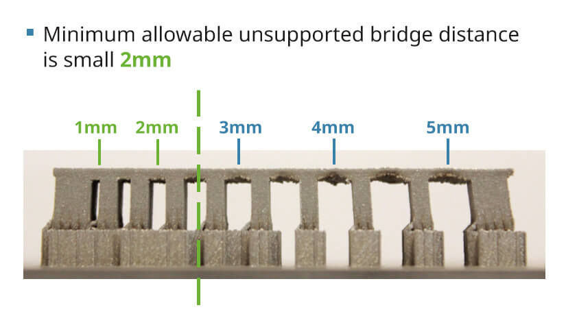

Let’s start with the letter A. Unless the horizontal crossbar is less than 2mm. across, vertical supports will be required beneath it to prevent warpage. Not a problem, but it’s going to cost a bit to grind or machine those supports away after the build. Same with a T—without supports beneath the overhanging top section, it’s going to curl up like a goalpost. Letters B, D, P, and R are especially problematic because the supports will be left inside the part, where they’re most difficult to remove. Curved shapes like O and Q fare no differently, unless the letters are quite small, about the diameter of a soda straw. In fact, about the only letters that won’t need any form of support are X and Y, provided the arms are angled at least 45 degrees from the horizontal.
In the "alphabet" example in this design tip, the letter A represents a part with a horizontal crossbar. Unless that crossbar is less than 2mm across, vertical supports will be required beneath it to prevent warping, as this example shows.
