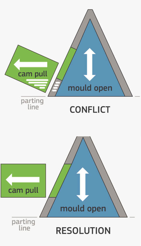

While side-actions are a relatively simple solution, there are a couple of things to keep in mind when using them. First, they must open perpendicular to the direction of mould opening. This would be simple if part walls didn’t have to be drafted and were always positioned vertically. Since walls are not always conveniently oriented, however, care must be taken to ensure that side-actions operate (and are, themselves, drafted) perpendicular to the direction of mould opening and not necessarily perpendicular to the surfaces on which they live.
 Imagine the window in Figure 1 as a skylight in the roof rather than a dormer window. (See Figure 2). A window perpendicular to the angled roof would be partially trapped as the cam opens sideways. Fortunately, most CAD programs allow you to define the face or plane to which a feature should be oriented and drafted. In this case, in creating the skylight you would simply orient perpendicular to the plane of the parting line rather than that of the roof.

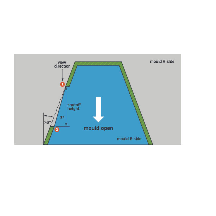

We’ve shown how removing a sill can eliminate the need for side-actions, but there are also instances in which a fully surrounded through-hole—a window for example—can be produced by sliding shutoffs. This is achieved by adding an increased amount of draft to a wall to allow the window to be formed partially by each of the two mould halves. The window in Figure 7 is formed by the sliding shutoff shown in Figure 8. In this case, the shutoff between the two mould halves angles across the window. The top edge of the window is formed by the B-side mould half; the bottom edge is formed by the A-side mould half. The two mould faces must be drafted by at least 3 degrees where they shut off (sliding shutoff). To allow this, the part wall itself must be drafted by more than 3 degrees. The additional amount by which the wall must be drafted depends on the part geometry.
How can you tell? Ask the following questions: (See Figure 8).
1. When looking down on your shutoff, can you clearly see edge 1 and edge 2? If 2 is hidden under 1, you cannot use this shutoff design.
2. Is the angle between edge 1 and 2 3 degrees or greater?
