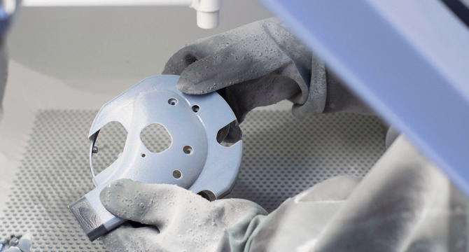

Surface Finishing
Standard
Expect roughness values of 0.004 to 0.010 Ra, depending on material and resolution. Support structures are removed and layer lines are visible. Parts get blasted to achieve a consistent overall texture.
Custom
Custom finishing for metal 3D-printed parts includes post-processing machining, heat treatments, and several brushed surface finishes in a range of grits. View a complete list of custom finishing options.
