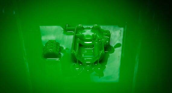

UV laser curving stereolithography part
Surface Finishes
UNFINISHED Dots, or standing"nibs," remain evident on the bottom of the part from the support structure remnants.
NATURAL
Supported surfaces are sanded down to eliminate the support nibs.
STANDARD
Supported surfaces are sanded, and the entire part is finely blasted for a consistent look. Note that the layers are still present.
