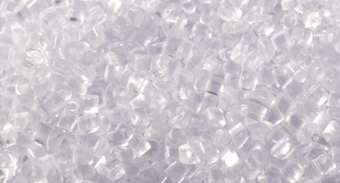

What is HDPE?
High-density polyethylene (HDPE) is a resin found typically in pellet form, intended to be used in injection moulding applications designed to withstand high impact, possess high-stress crack resistance, and have extreme durability. HDPE is also designed to provide excellent processability for moulders.

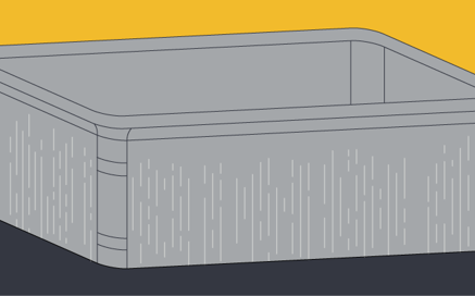

  • Industrial pails and parts
  • Shipping containers
  • Moulded crates
  • Cases
  • Totes
