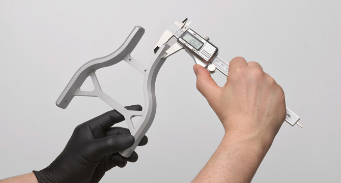

Ensure your parts meet critical dimensional and quality requirements with Protolabs’ comprehensive Measurement and Inspection Services. Whether you need standard quality checks or advanced metrology analysis, our engineers use both 3D digital scanning and tactile CMM equipment to deliver accurate, reliable inspection data.
Turnaround times vary based on part complexity, measurement volume, and quantity, ensuring the right level of detail for every project.
