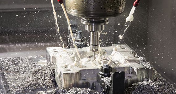

CNC Machining with HDPE
CNC machining is best for quick-turn prototypes or low-volume HDPE parts that don’t require mould investment. It’s great for fast design iterations—just keep in mind that HDPE’s softness can affect finish quality and fixturing.
Design Guidelines
  • Avoid overly thin or flexible geometries—HDPE can deflect under machining pressure
  • Provide extra fixturing or support features for long, unsupported sections
  • Use generous radii and avoid sharp internal corners to improve machinability
  • Consider surface finishing needs—HDPE’s softness means visible tool marks are common

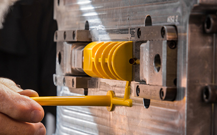

Injection Moulding with HDPE
When it’s time to scale up, injection moulding offers consistent part geometry, regulatory compliance, and efficient production for HDPE parts. The process supports higher volumes and tighter repeatability, but it requires careful design to manage shrinkage.
Design Guidelines
  • Use draft angles of at least 1° per side to ensure easy part release from the mould
  • Maintain uniform wall thickness (min. 1.5 mm) to reduce internal stress and warping
  • Avoid thick sections that can cause sink or increased shrinkage
  • Add fillets instead of sharp corners to improve flow and reduce stress
