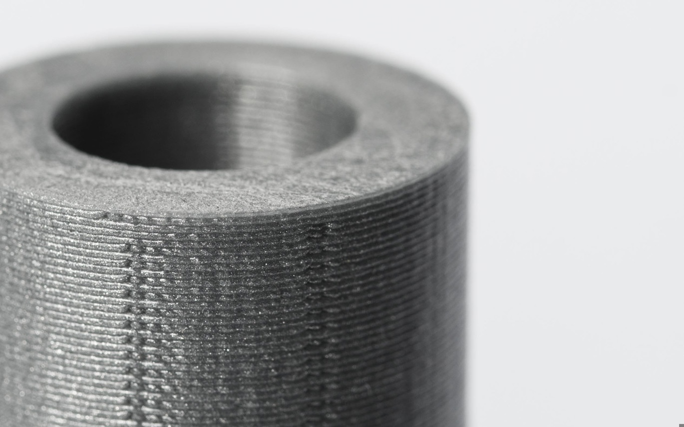

  • Layer-based processes like FDM can create anisotropic strength, meaning parts are weaker along certain orientations

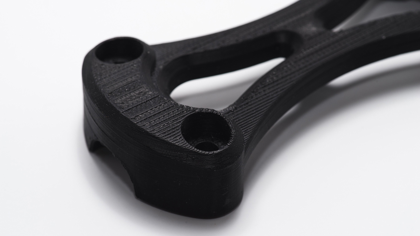

FDM provides durable parts with good mechanical properties, particularly for indoor applications. While highly versatile and cost-effective, typically shows visible layer lines. This can be addressed through design choices such as orienting critical surfaces or by applying post-processing methods.
