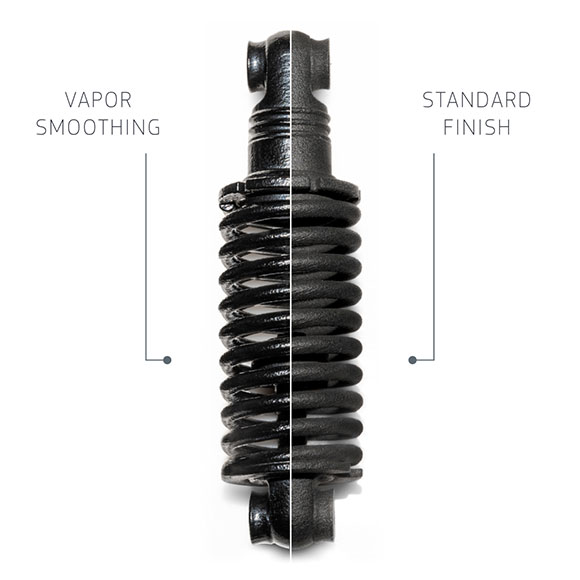

Vapor smoothing eliminates rough surfaces and leaves a glossy, aesthetic finish on parts
Two black 3D printed parts
The left part has been vapor smoothed. The right part has a standard finish.

After the parts have been 3D printed, they are transferred into a smoothing chamber. Using controlled evaporation, a vaporized smoothing agent condenses on the parts’ surfaces creating a controlled chemical melt. 
This process reduces peaks and troughs on the surface by liquifying and redistributing material evenly in a carefully controlled atmosphere. Once finished, the equipment evacuates the finishing agent to a collection vat so there is no residue left on the parts.
Benefits of Vapor Smoothing
Uniform color that showcases features and provides a clean appearance
Improved cosmetics over standard finish SLS and MJF parts
Significant reduction of surface roughness from 250+ μin RA (as-printed) to 64 – 100 μin RA (after smoothing)
Sealed surfaces that are liquid resistant and easy to clean
