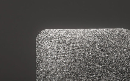

Straight Grain/Brushed
Designed for cosmetic and end-user-facing applications, our straight grain brushed finish creates a clean, uniform grain pattern that enhances the appearance of sheet metal parts. Grain direction can be applied parallel, perpendicular, or at a 45-degree angle to the part's longest edge or bend.
A note on welded parts: weld beads leave a raised surface at the weld site. Our process involves blending the weld bead into the metal material, leaving a uniform edge.

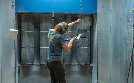

Powder Coating
Powder coating applies a dry powder to the surface of sheet metal parts. Then, they are cured in a large oven to create a hard finish that is tougher than conventional paint. This process improves durability to parts and adds custom color for aesthetic purposes.
Choose from 50 stocked colors for the fastest turnaround time. Various texture and gloss levels are available.
