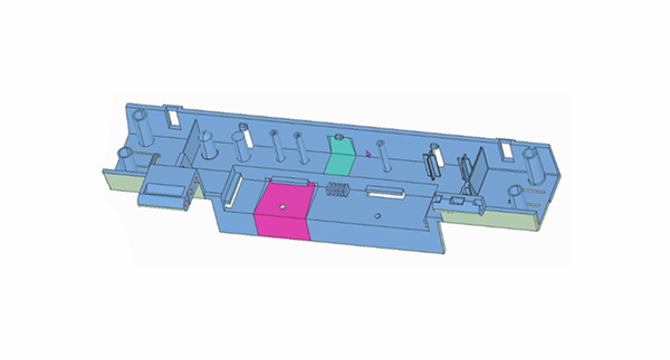

Design for Manufacturing (DFM) Analysis
When requesting a quote through our online quoting system, you will receive manufacturing analysis and pricing.
How our manufacturing analysis can improve quality of injection-molded parts:
  • Identifies thick walls
  • Identifies features with insufficient draft
  • Mold flow analysis
  • Select gate location
  • Select ejector pin location

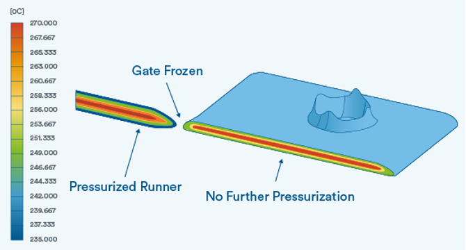

Scientific Molding: Consistently Delivering Quality Parts
We use scientific, or decoupled, injection molding to produce consistent parts for our customers. Each project has an optimized, documented process that ensures uniformity in every run. Modifications are tracked for traceability across runs. Scientific molding guarantees consistency in the process, meeting specific resin and dimensional requirements whether the part is re-run or ordered later. By controlling fill, pack, and hold, we ensure each part matches the previous one, providing benefits of higher quality and consistent inspection reports for our customers.

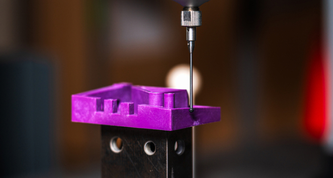

Injection Molding Inspection Reports
As part of the Protolabs standard, we measure up to four plane-to-plane and outside diameter dimensions based on your CAD model (X, Y, Z) to quoted tolerances. We automatically define these quality control checks and perform the measurements on a sampling of parts.
In addition, we provide a wide range of other quality documentation. Compare the benefits of each inspection report to see which is best suited for your project needs.

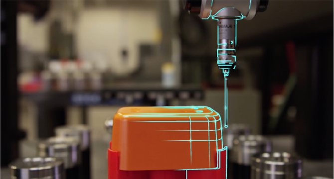

How are Part Dimensions Measured?
We use industry standard coordinate-measuring machines (CMM)—calipers and pin guages—just as you would expect from an industry leading manufacturing partner. What differentiates our process is that we’ve applied patented automation technology to our CMMs to enable in-process inspection with no additional cost or lead time.
Parts are measured at an equidistant cadence of n/30 where n = total part order quantity. Along with the measurement data from each part, the Capability Report will also provide the average measurement, standard deviation, and a Process Capability Index (Cpk) value for all critical dimensions.
