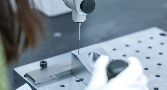

Verify Quality Throughout Production
After design review is complete, quality verification continues throughout manufacturing. In-process inspections help monitor critical features during production, while completed parts undergo visual and dimensional inspection before shipment.
Combined with standardized manufacturing processes and digital quality controls, these inspections help reduce variability, support consistent results, and provide greater confidence in the finished part.

Available Inspections
| First Article Inspection | |
| Benefits | Verifies the sample part conforms to all dimensions provided on a 2D drawing. |
| Measurements | Protolabs quality control will inspect 100% of dimensions provided on a 2D drawing, including GD&T. Quoted tolerances apply. |
| Services Provided By | Protolabs |
| Additional Features | FAI produced on a template conforming to AS9102C standard. |
| Eligibility | All |
| Additional Lead Time | 1 day |
| Price | Starting at $750 |
| Sample Plan | Revision CNC Machining Factory: After the parts have completed manufacturing, one piece from the lot is inspected to quoted dimensional tolerances and your visual standards. We perform AQL sample places for quantities over 50. Quick-Turn CNC Machining Factory: 100% of parts are inspected. |
| Additional Information | 2D drawing required |
| Dimensional Inspection Report | |
| Benefits | Verifies numerous dimensional specifications without requiring a 2D drawing. |
| Measurements | Protolabs quality control will inspect approximately 10 dimensions to quoted tolerances. GD&T will not be inspected. |
| Additional Features | Protolabs formatted report with bubbled part image and results summary chart. |
| Eligibility | All |
| Additional Lead Time | N/A |
| Price | Starting at $500 |
| Sample Plan | Precision CNC Machining Factory: After the parts have completed manufacturing, one piece from the lot is inspected to quoted dimensional tolerances and your visual standards. We perform AQL sample places for quantities over 50. Quick-Turn CNC Machining Factory: 100% of parts are inspected. |
| Basic Inspection | |
| Benefits | Additional QC checks available |
| Measurements | X, Y, and Z dimensions, thread functionality, visual, and up to 4 place to plane measurements as specified by customer. |
| Additional Features | Calipers and thread guages |
| Eligibility | All |
| Additional Lead Time | None |
| Price | $0 |
| Sample Plan | 100% |
| Additional Information | Additional customer specified measures, up to 4 plane to plane or hole features. CoC and CoA available upon request. |
| Material Certificate of Analysis | |
| Benefits | Protolabs standard Material Certification. A written confirmation providing traceability to the raw material used in your part(s), including material composition. |
| Measurements | N/A |
| Additional Features | N/A |
| Eligibility | All |
| Price | Starting at $60 |
| Sample Plan | N/A |
| Certificate of Conformance | |
| Benefits | Protolabs quality control will inspect parts to conform to quoted standards. No inspection documentation will be provided. |
| Eligibility | All |
| Price | $0 |
| Sample Plan | N/A |
| Inspections without Report | |
| Benefits | Our basic QC process |
| Measurements | X, Y, and Z dimensions, thread functionality, and visual |
| Additional Features | Calipers and thread gauges |
| Eligibility | All |
| Price | $0 |
| Sample Plan | 100% inspection |
| Additional Information | CoC and CoA available upon request. |
