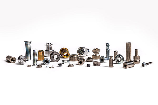

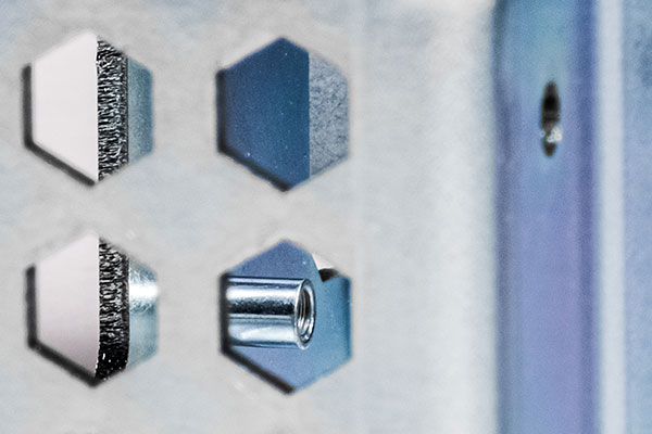

Hardware Insertion Guidelines
An extensive stocked library of fasteners is available from brands such as PEM and Southco.
File Formatting:
- Recommended: Include any hardware in your 3D CAD model as separate solid bodies from the main sheet metal body. Use industry standard hardware part numbers when possible (e.g. CLS-M6-1)
- Alternative: Upload your CAD file without hardware and include a 2D drawing noting hardware types and locations.
We offer a huge variety of PEM hardware. Avoid issues with placement while still in the design phase with these guidelines.
Examples of Available Hardware Types to Customize Your Project:
- Self-clinching nuts
- Self-clinching standoffs
- Flush-head studs
- Miniature self-clinching nuts
- Self-clinching flush nuts
- Flush-head pins
- Self-clinching blind fasteners
- Thin sheet non-flush studs
- Self-clinching lock nuts
- Self-clinching micro pins
- Panel fasteners

- For inserts to grip the sheet metal correctly, the material of the hardware insert must have a hardness equal to or greater than the material into which it is inserted. Further details on hardware and material compatibility can be found in our Design for Manufacturability Toolkit.
- Our design tip on effective hardware integration covers hardware use cases and part placement considerations.

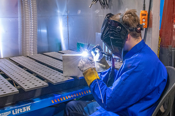

Welding Guidelines
Welding is available to join or fuse your metal components into their assembled form. Our most common welding capabilities include gas metal arc welding (MIG) and gas tungsten arc welding (TIG).
Welding Design Guidelines:
- To avoid material warping or “oil canning,” the minimum material thickness for welded assemblies is 0.042 in. (1.07mm).
- Maximum material thickness for welded assemblies is 0.250 in. (6.35mm).
- Always specify welding location requirements on your 2D drawing.
- If possible, avoid specifying a welding method, unless required for functionality.
- Material types must be consistent across parts when welding multiple geometries.
Riveting is an option to consider if you are looking for additional flexibility when joining your metal components. Riveting is a technique in which components are joined using a type of hardware called a rivet. For more information, review our blog post on the different advantages of welding or riveting your next project.
Lead Time: Welding adds 1 business day.

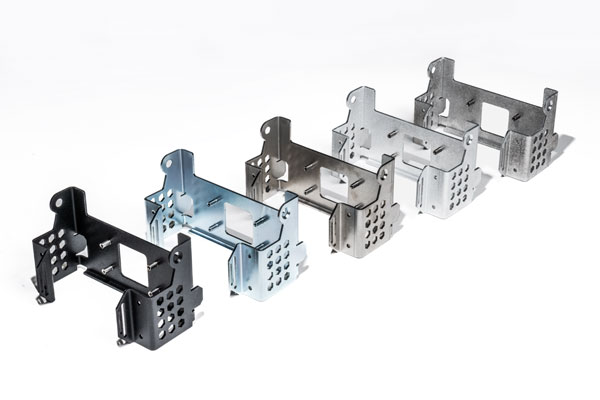

Finishing Options for Assemblies
In addition to feature or geometry customization, our finishing services for components and assemblies allow for customization of your aesthetic requirements. Our finishing options include:
- Plating
- Powder coating
- Wet paint
- Masking
- Part marking
- Metal surface finishing
Lead Time: Most finishing options add 1-2 days per finish. See our finishing options page for more details.
