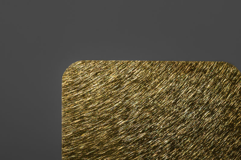

Brass C260
Aesthetics
Formability
Corrosion Resistance
More Detailsexpand_circle_down
Less Detailsexpand_circle_up
Brass C260 is primarily composed of copper and zinc, giving it the golden-yellow color for which it is known. Mechanically, Brass has corrosion-resistant and formable qualities similar to Aluminum 5052. Brass is heavier than aluminum, making it well suited for aesthetic or decorative applications.
Tensile Strength
427.475 MPa
62 kpsi
Elongation
25%
Hardness
70 HRB
Max. Part Size:
457.2mm x 609.6mm
18 in. x 24 in.
Thickness Range:
.635mm to 3.175mm
.025 in. to .125 in.

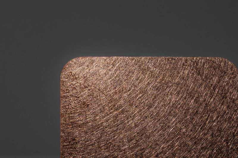

Copper C101
Electrical Conductivity
Thermal Conductivity
Formability
Copper 101 (C101) is known as oxygen free electronic or OFE Copper. It is primarily chosen when material impurities are undesired and electrical conductivity is crucial. It offers strong corrosion resistance and formable qualities but is more costly than oxygenated Copper 110. C101 is typically used for applications where exceptional conductivity is favored over cost savings.
Tensile Strength
282.685 MPa
41 kpsi
Elongation
14%
Hardness
40 HRB
Max. Part Size:
457.2mm x 609.6mm
18 in. x 24 in.
Thickness Range:
.813mm to 3.175mm
.032 in. to .125 in.
Copper C110
Cost Effectiveness
Formability
Copper 110 (C110) is the oxygenated relative of Copper 101. Containing only a small amount of oxygen, C110 is more widely used for practical applications such as heat exchangers, wiring, and plumbing components. C110 is more readily available and is a lower cost copper option without trading off the formability characteristics of C101. While a strong electrical conductor and corrosion resistor, C110 contains impurities in the form of oxygen which can’t stand up to the purity of C101.
Tensile Strength
282.685 MPa
41 kpsi
Elongation
14%
Hardness
40 HRB
Max. Part Size:
457.2mm x 609.6mm
18 in. x 24 in.
Thickness Range:
.635mm to 3.175mm

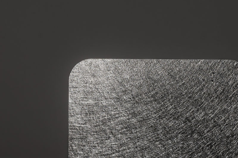

Stainless Steel 304/304L
Formability
Weldability
Strength
Durability
Stainless Steel 304 comes in two varieties, 2B and #4. These identifiers refer to the surface finish applied at the mill, but the underlying material is the same.
2B has a low shine appearance, whereas #4 has a brushed aesthetic from a mechanical polishing process. 2B typically costs less than #4, however both are formable and weldable. Of note, welding 304-#4 can remove the desirable brushed finish. 304 provides only adequate corrosion resistance and is particularly risky in high-chloride environments such as saltwater or coastal regions.
Tensile Strength
586.054/551.581 MPa
85/80 kpsi
Elongation
55%/55%
Hardness
70 HRB
Max. Part Size:
990.6mm x 1193.8mm
39 in. x 47 in.
Thickness Range:
.609mm to 6.35mm
.024 in. to .250 in.
