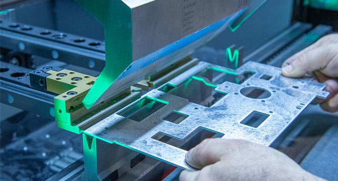

Press brake forming is a metal fabrication process that bends flat sheet metal into a final shape using a press brake machine. Force is applied between a punch (upper tool) and die (bottom tool), and linear bends can be made for a variety of metal materials and thicknesses. All brakes are equipped with CNC controllers for precise part positioning and repeatability. Press brake forming works well to create parts that include U-bends, flanges, channels, and internal bends. Lead times for qualifying formed parts are as fast as three days.
