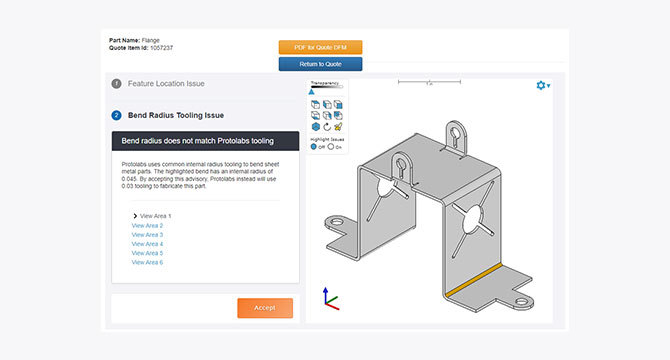

Internal Radius Tooling Options | |||
0.01 in. | 0.09 in.* | 0.25 in. | 0.625 in. |
0.03 in.* | 0.12 in.* | 0.375 in. | 0.75 in. |
0.06 in.* | 0.188 in. | 0.5 in. | 1 in. |
*If lead time is a priority, consider one of these options in your part design
- For parts with internal radii greater than 1 inch, Protolabs will use a technique called “bump” forming (multiple tooling lines will be present).
