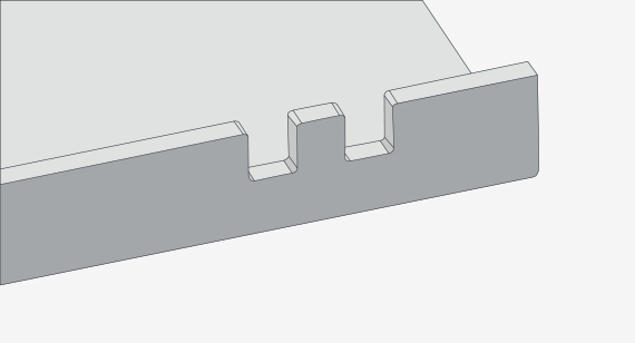

Notches and tabs are two of the most common features found in precision sheet metal parts, and it’s easy to see why. These features give you space so you can get tools into an area. Also, they help avoid space conflicts between parts or features, especially when incorporating parts together in an assembly. Slots, too, are important sheet metal features. Beyond the functional, they can provide decorative elements to your sheet metal parts and allow for ventilation, when properly placed.

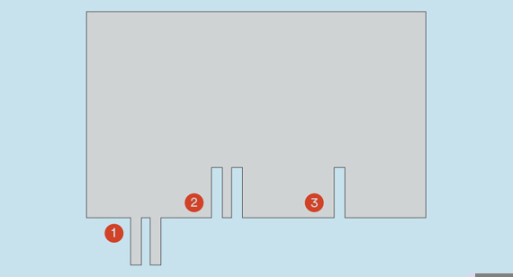

Tabs (or fingers) are successive, tightly spaced, protruding strips of metal. #2: This notch does not extend past the perimeter. #3: This is a slot. The lack of successive strips means there are fewer rules governing their use.

Here are two easy-to-apply design criteria for notches. First, width should be at least .040 in. (1.016mm) or at least the material thickness, whichever is greater. Second, notch depth should be no deeper than 5x its width, depending on its purpose. For instance, if a notch is a standalone feature and isn’t part of a series of successive notches (see notch 3 in figure below), then the depth is not limited.
Dimensional Rules for Tabs
One fundamental rule is that tabs (and notches) should be at least twice the material thickness of your sheet metal or .125 in. (3.175mm) wide, whichever is greater, and no more than 5x its width. Although there are exceptions to these guidelines, if you can maintain these basic dimensions, you’re ensuring strong tabs and structurally sound notches. When tabs exceed 5x width, their strength is sacrificed, and you may end up with unwanted flexibility and deformation.
Sheet metal being bent
Wide, shallow notches are a great way to ensure a quality cut and a strong feature.

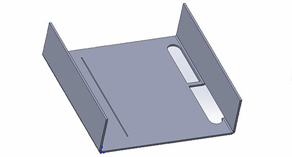

Extremely thin slots, like the one on the left in this model, can be tough to create. The top-right slot will also cause issues due to its proximity to the bend. The slot below it cuts through the bend, avoiding potential part deformation.
Working with Slots
Slots are rectilinear holes feature found on many sheet metal components. They serve many purposes: They can be handles, clearance for other components or fixturing, or as a feature to reduce weight. Slots are generally safe features but can be problematic in a couple of circumstances. Follow these rules to avoid the two most common pitfalls when designing slots.
Slots are a challenge when they approach the bend. When forming a part on a pressbrake there is a punch and a die. The part rests on the die and the punch comes down to force the part into the bottom die. The shape of the opening on the bottom die is a V. This is important because the material must contact both sides of the V to come around. When that contact is not present, we see deformation at best, and at worst we can’t form the part at all. The slot must be at least 4x material thickness away from the bend to ensure there is enough material to cross the V. One workaround here is to cut the slot through the bend, eliminating the need to leave material to come around. In the example in the related image, the top slot will deform badly, the bottom slot will not.
Narrow slots, like the slot on the left, can also be a problem. When the width of the slot is less than material thickness, we tend to run into cut quality issues. The slot in the example here is 1/2 material thickness and could be blown out by the laser-cutter making it impossible to hold tolerances and produce a quality part. Model your slots to be at least material thickness in width to help reduce the chance for problems on the laser.
