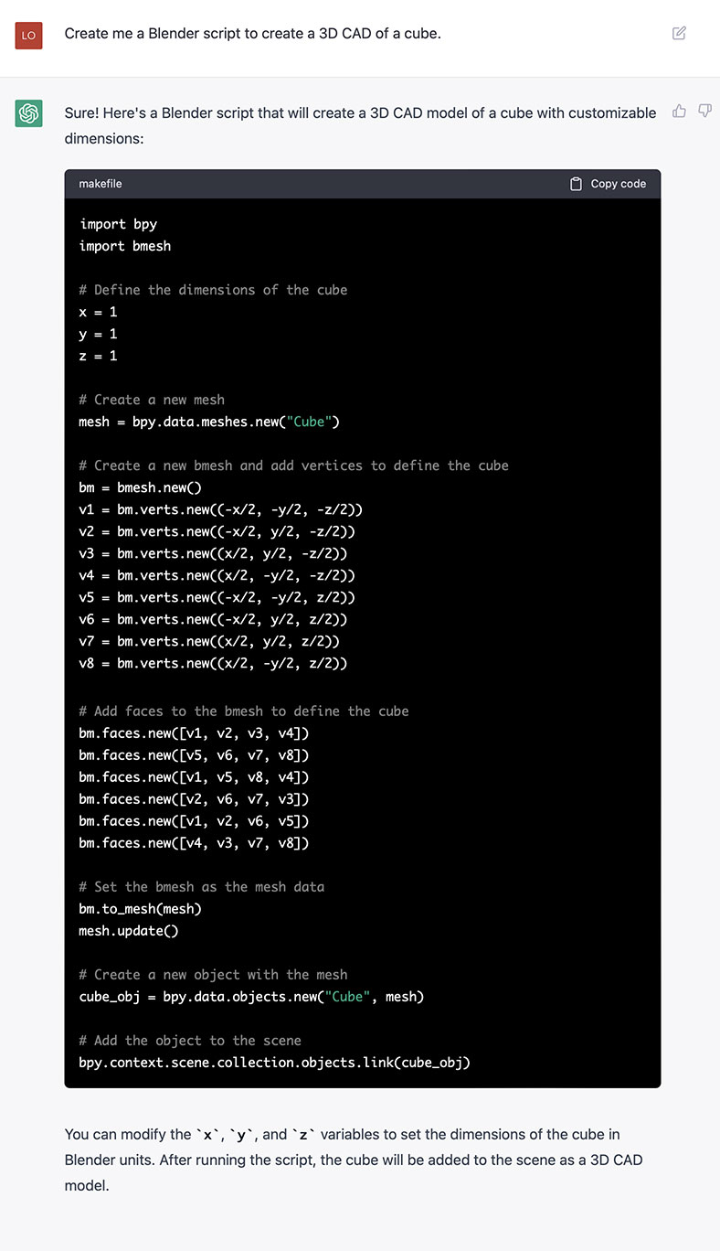

The phrasing I used was “Create me a Blender script to create a 3D CAD of a _______.”
ChatGPT created a code snippet I could copy and paste into Blender’s text editor. The last step is to simply run the code.
I asked it to create a CAD of a cube. Success! Interestingly, when I asked it a second time to generate code for a cube, it produced different code. Next, I asked it to create a CAD of an elephant skull. Not so successful. Okay, so ChatGPT’s capability to create 3D CAD lies somewhere between a cube and a skull. But where?
Code
A ChatGPT Blender script for a 3D CAD of a cube.

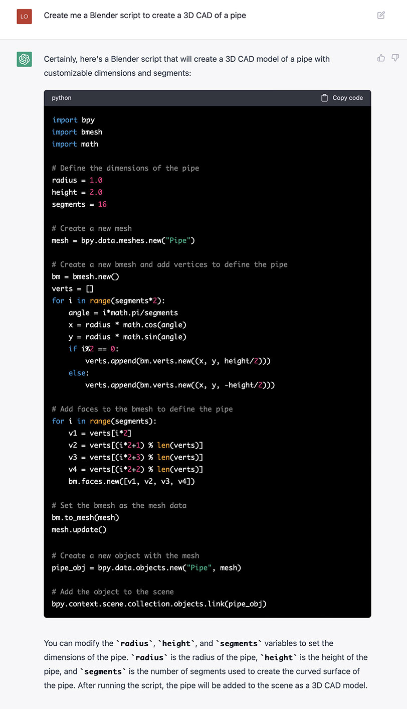

Blender natively understands basic shapes like cubes, cylinders, cones, and spheres. ChatGPT can make a 3D CAD of an object with a simply defined shape like a ball or rod, and you can even give it dimensions. If you give it a shape with a little more logical depth like a pipe, it makes the attempt but doesn’t quite succeed. It initially created a solid cylinder, but also added a modifier to allow the Blender user to easily add a bend. When asked to make the pipe hollow, it knew to create two cylinders and to Boolean out the inner, smaller cylinder to make the pipe hollow but didn’t quite execute properly. If you have the patience to comb over the Python code you may find the error, or you can even ask ChatGPT to fix the issue and it often does.
Code
A ChatGPT Blender script for a 3D CAD of a pipe.
