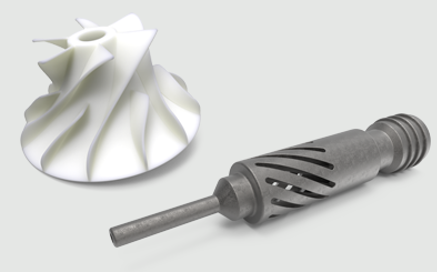

Both use a heated chamber and build a 3D plastic structure by adding successive layers that are just microns thick. The difference is that selective laser sintering, or SLS, uses a laser to fuse powder layers together, whereas MJF uses an infrared heating element.  Neither need support structures for the process.

MJF also has more consistent isotropic material properties. This means that it has more consistent mechanical properties in every direction or axis of your part.  So if you want great strength and reliability for every bit of your part, then MJF could be the answer. This makes MJF really good for parts like brackets and clips or durable but accurate jigs and fixtures.

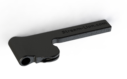

Thin walls or large flat surfaces should be reinforced with ribs or gussets and holes should be surrounded by raised bosses.
Raised text and cosmetic part features smaller than 0.5mm may not survive secondary post processing, so check your design for manufacturability analysis from your supplier.
The ideal wall thickness for MJF is between 2.5mm and 3.8mm.
And just so that you know, like any 3D printing process, MJF will produce some stair stepping on oblique angles. This means that you should clearly identify cosmetic surfaces on the part drawing.
