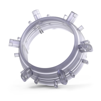

transparent polycarbonate part
Polycarbonate is a versatile material choice that stiff parts with excellent heat deflection. Multiple polycarbonate-like materials are available through our stereolithography (SLA) process.
  • PC-Like Advanced High Temp (Accura 5530)High elastic modulus, can be thermal cured for increased heat deflection as high as 250°C
  • Ceramic-Like Advanced High Temp (PerFORM)Stiffest SLA material, can be thermal cured for increased heat deflection as high as 268°C
View Polycarbonate 3D Printing materials
