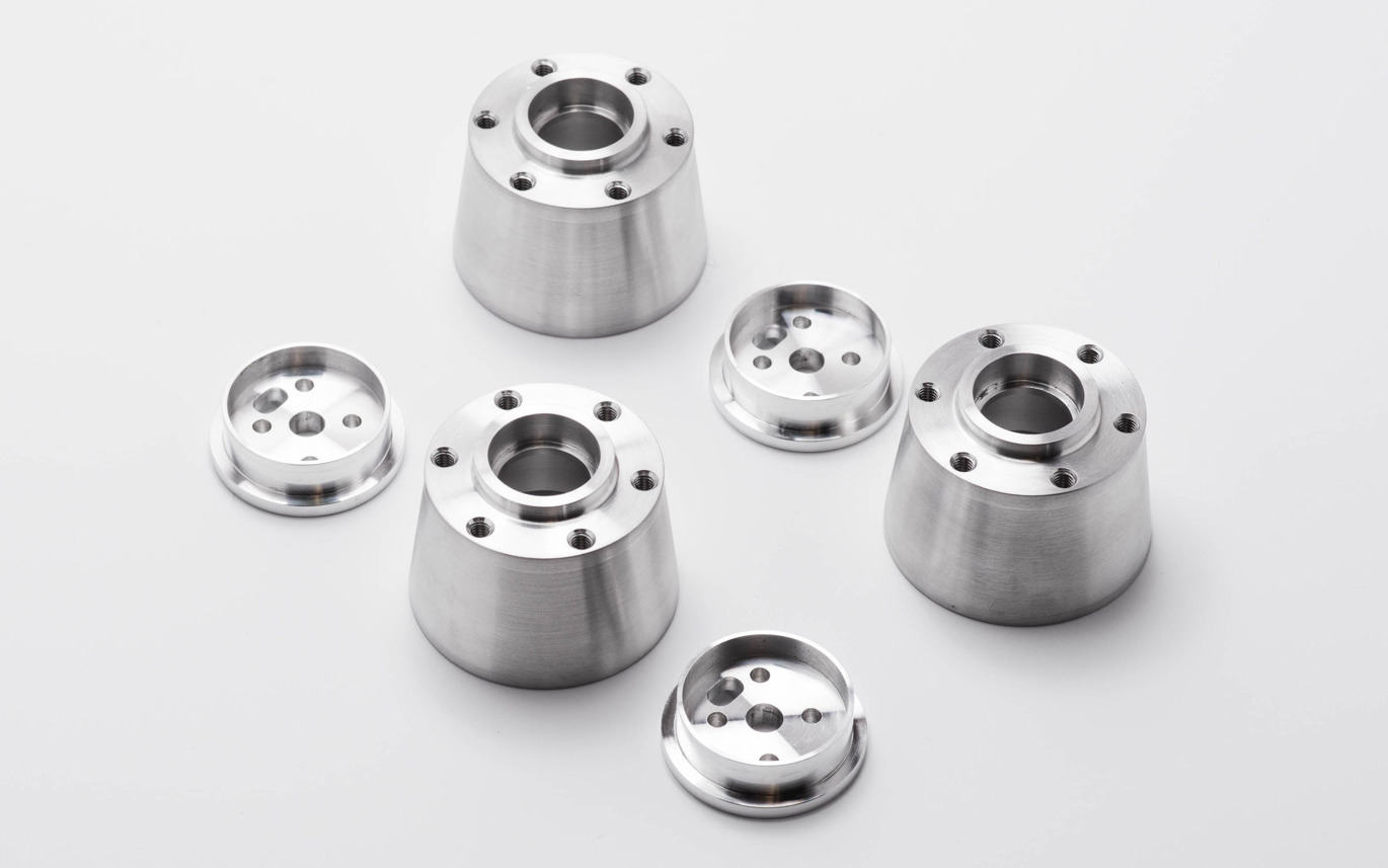

Holes might look like one of the simplest features in a part, but they can be tricky to machine because the cutting tool has to work inside a confined space, where access, chip removal, heat, and tool rigidity all become more difficult.
Design choices like depth, diameter, and placement can affect accuracy, machining time, and cost. Knowing the different types of CNC machining holes, and when to use each one, makes it easier to design parts that do what you need without adding unnecessary complexity. Here is an overview of the most common hole types, practical design tips, and a few common mistakes to avoid.
Common Types of CNC Machining Holes
Most engineers are familiar with holes—black holes and rabbit holes included—but there are a few more practical types worth knowing if you want to avoid tumbling down the metaphorical ones.
Some holes provide clearance for fasteners, while others align mating parts with locating pins, carry fluids, or create a threaded connection. And although we often talk about “drilling” holes, that’s only one way to make them. Depending on the diameter, tolerance, material, and finish you need, a CNC hole might be drilled, interpolated with an end mill, or reamed.
Here are the most common types you’ll run into:

Generally, it’s a good idea to choose standard hole and fastener sizes when they meet your requirements, since added complexity can bloat your budget and stretch your schedule. At Protolabs, however, most milled holes are interpolated with an end mill, so engineers can specify the diameter their design needs.
Hole Diameter and Depth
Deep holes are harder to machine because chips are more difficult to clear and longer tools are more likely to flex. Keep holes only as deep as needed, and use a through hole instead of a blind hole when the design allows.
