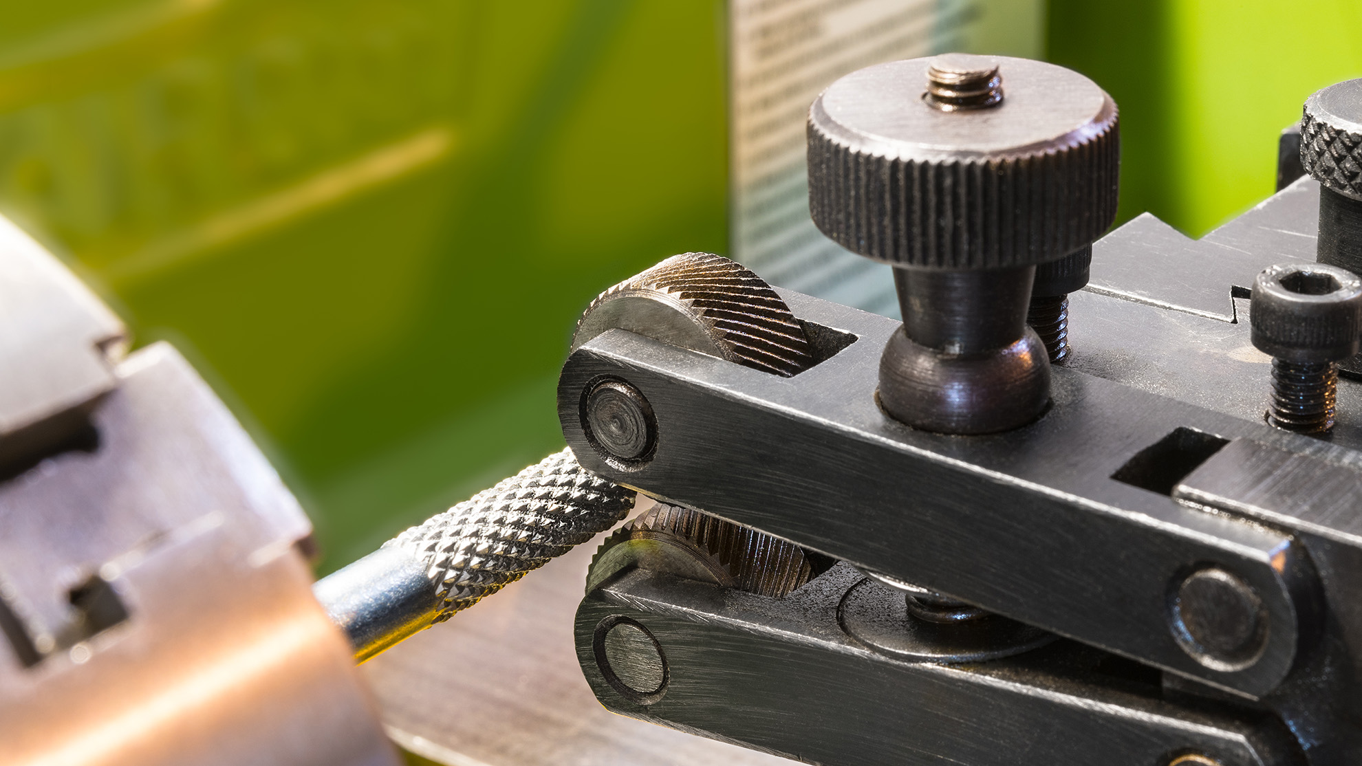

How Knurling Works
Knurling works by pressing a patterned tool against a spinning part to create a textured surface. This is called a forming process, because it shifts material instead of removing it. It’s most often done on a lathe using a hardened roller that embosses the pattern as it moves along the part.
In some cases, especially with harder materials, a cut knurling method is used. This actually removes material to form the pattern. This is used when you need a very crisp texture or are working with thin-walled or brittle components.
A few key factors affect how the knurling turns out:
  • Tool pressure: More pressure means a deeper pattern
  • Feed rate: Controls the spacing and alignment of the texture
  • Material hardness: Softer metals knurl easily, but if it is too soft, you can lose detail
  • Tool shape and pitch: Determines how the pattern looks and feels
Forming knurling will slightly increase the diameter of your part, so keep that in mind, particularly if the knurled area needs to fit with another component.

Knurling Methods: Manual vs. Machine
The method used depends largely on production volume, precision requirements, and available equipment.
Manual knurling
This method is typically done on a manual lathe, using a handheld or lathe-mounted knurling tool. It requires operator skill to maintain consistent pressure and feed.
  • Ideal for prototypes or small batches
  • Slower and more labour-intensive
  • Prone to slight variation in pattern depth and spacing
Machine knurling
This technique is often done on CNC lathes or turning centres, uses automated tool paths and pressure control to achieve consistent, repeatable results.
  • Suitable for high-volume production
  • Capable of tight tolerances and consistent surface finish
  • Integrated easily into multi-step machining operations
