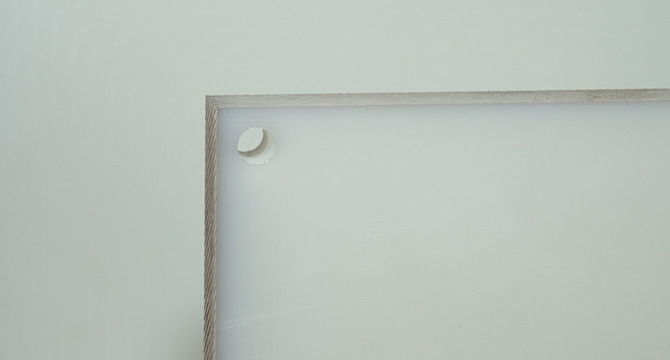

  • Ideal for prototypes and low-volume parts: Fast turnaround with good dimensional control.
  • Tolerance: Aligns with ISO 2768-medium unless otherwise specified.
  • Colours: Available in black and natural; natural is FDA-approved in EMEA. Additional options are available on request.
  • Surface finish: Typically milled and matte, depending on toolpath and speed.
  • Flexibility considerations: Parts may require fixturing due to HDPE’s softness.
  • Wall thickness: Can accommodate thinner walls than injection moulding depending on part geometry, though strength and accuracy may vary.
