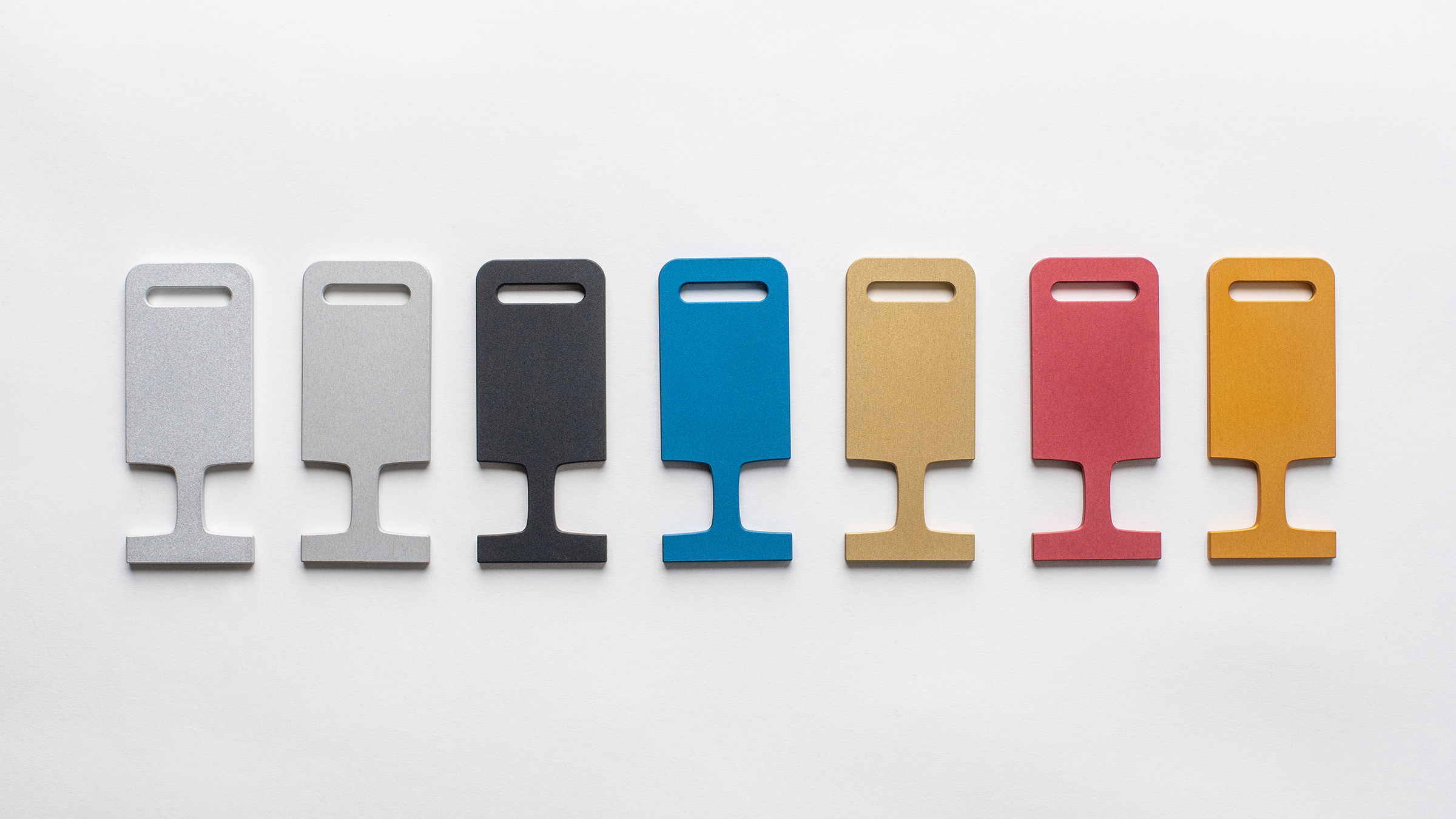

Because the oxide layer is porous, it can soak up dye when you want to add colour. How much colour it holds depends on the dye strength, temperature, and how long the part stays in the bath. A final sealing step closes those pores to lock everything in.

- Colouring (optional): If you want colour, in this step the porous oxide layer gets soaked in a dye bath to absorb pigment. The longer it stays in, the deeper the colour.
