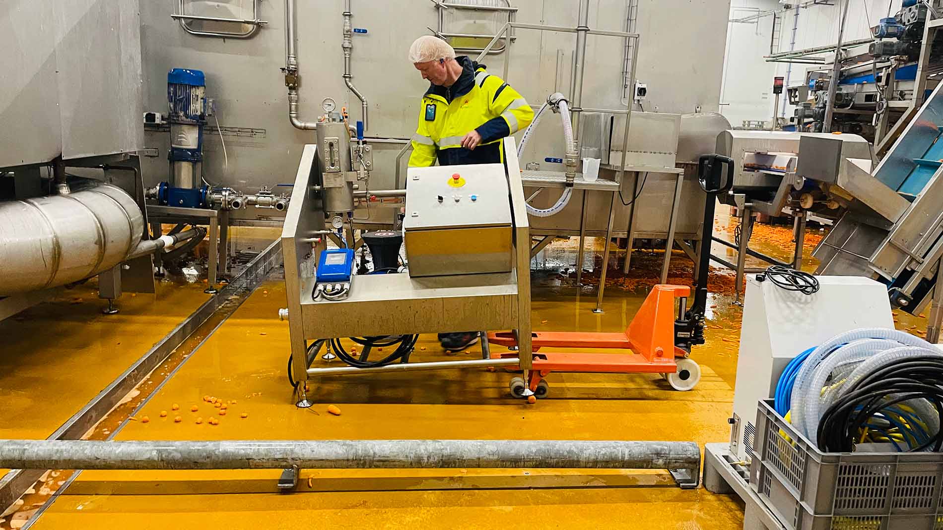

Arrow Lake utilises Protolabs Injection Moulding service
Circular process
Arrow Lake was founded in 2016 by Ali Jehanfard, Claes Gustafsson, Olof Österlind and Martin Belohorka. Since its inception, Arrow Lake has focused on developing systems such as QUBE® and The FLO3W®. Both of these contribute to more energy-efficient solutions and help customers reduce their consumption of water. Energy efficiency and reduced waste pervade everyday life for everyone at Arrow Lake.
The FLO3W® is based on a circular process that begins by adding ozone, mixing it with water until it is completely dissolved, and then continuously measuring the ozone level in the water and adjusting the amount as needed. The result for customers is a more efficient system, products that require less refrigeration, have a longer shelf life and the use of chemicals is reduced. The solution is used to treat everything from pomegranates, peaches, apricots, cherries, basil and parsley to carrots, potatoes, broccoli and cauliflower all over the world.

One of the great advantages of The FLO3W® is that the ozone is injected directly into the water. With other solutions on the market, a large part of the ozone often disappears into the air, so-called off-gas. This means that it is difficult to know how much ozone has actually dissolved in the water and it may not be enough to work effectively. The FLO3W®, on the other hand, provides continuous measurable and stable levels of ozone that prevents the growth of bacteria and other microorganisms in the water.
Because The FLO3W® is so resource-efficient, the water does also not need to be changed as often, resulting in both lower costs and less environmental impact.
