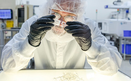

Each eyeWatch implant is delivered with two specific tools: a marker used as a buffer to demarcate its location before the placement of the drainage plate and a clamp that holds it securely during insertion without causing damage.
These tools were designed by Rheon Medical and initially manufactured using 3D printing. Their original design was later improved based on feedback from the first surgeons who used them. They are now produced in small batches using Protolabs' injection moulding machines. "Our ancillaries are used in microsurgery, so they need to take up as little space as possible," explains Constantinos Stergiopulos, CTO of Rheon Medical. "The first version of our clamp was deemed too thick by the surgeons who used it, so we refined the design before moving on to mass production. And we were able to validate our choices thanks to the design analysis provided by the digital quoting platform."
