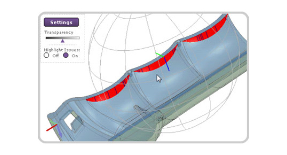

Example of interactive CAD model
As a part of your quote, ProtoView, the view of your 3D CAD model, allows you to examine and manipulate the model.
By moving the transparency slider in ProtoView to fully transparent, you're able to hide all of the areas of your part do not need to be addressed, leaving only the important design considerations. It brings into focus any areas that need further review. Those may include undercuts, draft, surface finishes, wall thickness and material flow:
