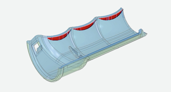

At the heart of the quoting system lives Protolabs' manufacturability analysis of part designs that we provide to ensure you get well-molded parts. Within the quote analysis, you’re able to access an interactive three-dimensional image of your part design, which allows you to review your part geometry and assess any potential design issues that are highlighted. Some issues will be identified in the required changes tab, and those changes will need to be modified before your parts can be made. Issues that are not critical to part production will be listed as advisories. Those advisories do not require change, but do indicate design considerations for optimal performance in the manufacturing process you choose.
By moving the transparency slider in in the 3D viewer to fully transparent, you’re able to hide all of the areas of your part that do not need to be addressed, leaving only the important design considerations. It brings into focus any areas that need further review. Those may include undercuts, draft, surface finishes, wall thickness, and material flow.
Undercuts. The process supports simple undercuts in your part geometry. A side-action can be built into your part design to create a through-hole undercut feature, if needed. The maximum side-core dimensions are: 8.419 in. (width), 2.377 in. (height) and 2.900 in. (pull).
Draft. If your part has very little to zero draft, a required change or advisory may appear in your quote. Draft is recommended on all parts, and Protolabs recommends adding 0.5 degree of draft on all vertical faces, if possible. In most cases, applying 2 degrees of draft where possible is best for molding, but is not required. If you choose to ignore a draft advisory, Protolabs will make your part as-is, without draft in the noted area, but issues can arise such as drag marks, distortion from ejection stresses, or other effects that can cause delays.
![Example of interactive CAD model](/media/681198/dfm-designtip-macro-900x400.jpg?width=570&height=308&rnd=131369067224630000)
