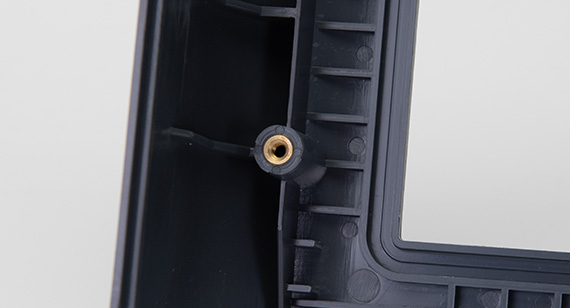

Threaded inserts are possible through secondary heat staking and ultrasonic welding processes. A complete chart of stocked inserts is available here.

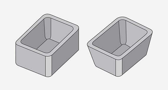

Draft
VERTICAL FACES
0.5°
MOST SITUATIONS
2°
MINIMUM FOR SHUT OFF 3°
MINIMUM FOR LIGHT TEXTURE (PM-T1) 3°
MINIMUM FOR LIGHT TEXTURE (PM-T2) 5°+

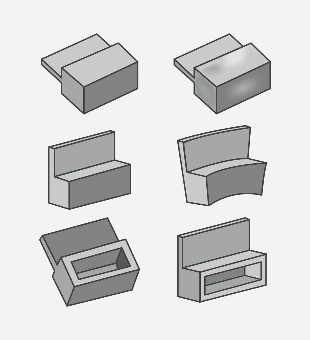

Undercuts
 Maximum Side Core Dimensions
WIDTH HEIGHT PULL
< 8.419 in. < 2.377 in. < 2.875 in.
WIDTH HEIGHT
PULL
< 213.84mm < 60.38mm < 73.66mm

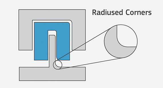

Radii
Some part corners will have a radius rather than a sharp edge since we use an automated CNC milling process to make the mold for your parts. This typically does not require a change to your model, but resulting radii are identified before the mold is milled.
