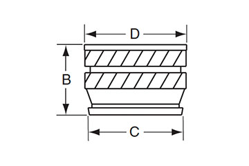

Long

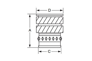

Short
| INS # | Thread | Length |
| INS-PL0001 | 2-56 UNC | 0.156 in. |
| INS-PL0002 | 4-40 UNC | 0.205 in. |
| INS-PL0003 | 6-32 UNC | 0.25 in. |
| INS-PL0004 | 8-32 UNC | 0.25 in. |
| INS-PL0005 | 10-24 UNC | 0.356 in. |
| INS-PL0006 | 1/4-20 UNC | 0.344 in. |
| INS-PL0007 | M3x5 | 5.21mm |
| INS-PL0008 | M4x7 | 6.35mm |
| INS-PL0009 | M5x8 | 7.13mm |
| INS-PL0010 | 2-56 UNC | 0.125 in. |
| INS-PL0011 | 4-40 UNC | 0.187 in. |
| INS-PL0012 | 6-32 UNC | 0.219 in. |
| INS-PL0013 | 8-32 UNC | 0.312 in. |
| INS-PL0014 | 10-24 UNC | 0.281 in. |
| INS-PL0015 | 1/4-20 UNC | 0.5 in. |
| INS-PL0016 | M3x5 | 4.77mm |
| INS-PL0017 | M4x7 | 8.00mm |
| Inch | Metric | A | B | C | D | E | F | Min. Boss | ||
| Thread Size | Part Number | Thread Size | Part Number | ± 0.004 in. (long) | ± 0.004 in. (short) | ± 0.004 in. | ± 0.004 in. | 0.002 in. | 0.002 in. | |
| 2-56 | 256 x 115H | M2.0 x 0.4 | M20 x 115H | 0.115 in. | 0.123 in. | 0.141 in. | 0.129 in. | 0.118 in. | 0.246 in. | |
| 256 x 188H | M20 x 188H | 0.188 in. | 0.112 in. | 0.141 in. | 0.123 in. | 0.107 in. | 0.246 in. | |||
| 4-40 | 440 x 135H | M2.5 x 0.45 | M25 x 135H | 0.135 in. | 0.157 in. | 0.172 in. | 0.159 in. | 0.153 in. | 0.318 in. | |
| 440 x 219H | M25 x 219H | 0.219 in. | 0.146 in. | 0.172 in. | 0.159 in. | 0.141 in. | 0.318 in. | |||
| 6-32 | 632 x 150H | M3.5 x 0.6 | M35 x 150H | 0.150 in. | 0.203 in. | 0.219 in. | 0.206 in. | 0.199 in. | 0.412 in. | |
| 632 x 105H | ||||||||||
| 8-32 | 832 x 185H | M4.0 x 0.7 | M40 x 185H | 0.185 in. | 0.230 in. | 0.250 in. | 0.234 in. | 0.226 in. | 0.468 in. | |
| 832 x 312H | M40 312H | 0.3127 in. | 0.213 in. | 0.250 in. | 0.234 in. | 0.208 in. | 0.468 in. | |||
