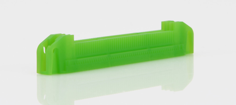

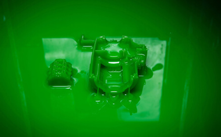

High Precision 3D Printing with MicroFine
MicroFine™ is an SLA material only available through Protolabs. The material enables us to achieve features as small as 0.07 mm. In terms of its mechanical properties, the material is fairly durable, rigid, and most similar to an ABS plastic. Smaller features built in MicroFine are best dialed in when parts are around or less than 25 mm x 25 mm x 25 mm.

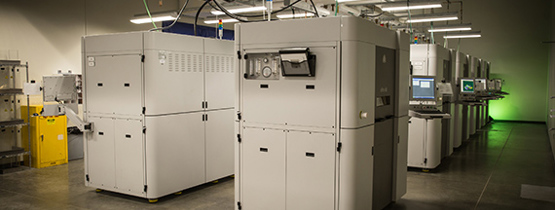

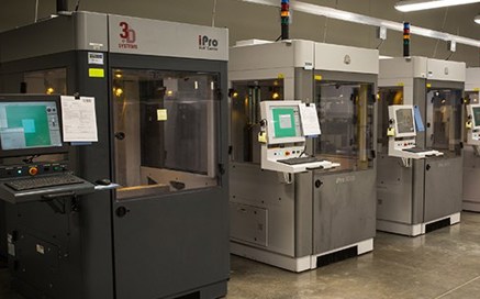

Our Plastic 3D Printers on Site
Our fleet of plastic 3D printers consist of a range of machines to support various material options, build volumes, and resolutions (normal, high, and micro).
  •  Stereolithography: Viper, ProJets and iPros
  •  Selective Laser Sintering: sPro60 and sPro140
  •  Multi Jet Fusion: HP Jet Fusion
  •  PolyJet: OBJET 500 Connex 3 and Keyence AGILISTA 3200W
