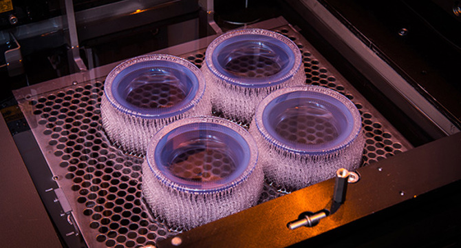

ABS or Acrylonitrile Butadiene Styrene is available through our 3D printing service. It's an all-purpose material that produces parts with fine features and smooth surface finishes.
We carry five ABS materials for 3D printing:
ABS 3D Printing Material Properties
| Material | Process | Colour | Tensile Strength | Tensile Modulus | Tensile Modulus | Description | More Details |
| ABS-Like White (Accura Xtreme White 200) |
SLA | White | 55 +/- 10 MPa | 3,300 +/- 400 MPa | 5% +/- 5% | Durable, general purpose resin and accommodates extra-large parts | Data Sheet |
| ABS-Like Gray (Accura Xtreme Gray) |
SLA | Grey | 40 +/- 8 MPa | 2,000 +/- 400 MPa | 9% +/-5% | General purpose resin with highest heat deflection temperature of the ABS-like SLA resins | Data Sheet |
| ABS-Like Black (Accura 7820) |
SLA | Black | 55 +/- 10 MPa | 3,000 +/- 400 MPa | 5% +/- 3% | Low moisture absorption, glossy cosmetic appearance | Data Sheet |
| ABS-Like Translucent/Clear (WaterShed XC 11122) | SLA | Translucent/Clear | 55 +/- 10 MPa | 2,900 +/- 400 MPa | 6% +/- 3% | Lowest moisture absorption of SLA resins, functional transparency | Data Sheet |
| ABS-MicroFine™ | SLA | Green | 60 +/- 10 MPa | 2,600 +/- 400 MPa | 8% +/- 4% | Produces highest resolution parts, ideal for extra-small parts | Data Sheet |
