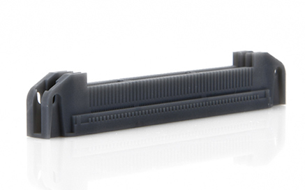

ABS-like Gray (Accura Xtreme Gray) | General purpose resin with highest heat deflection temperature of the ABS-like SLA resins |

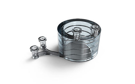

ABS-like Translucent/Clear (WaterShed XC 11122) | Lowest moisture absorption of SLA resins, functional transparency |

SLA | Gray | 5.8 ksi | 290 ksi | 9% |

ABS-Like Translucent/Clear (WaterShed XC 11122) | SLA | Translucent/Clear | 7.9 ksi | 421 ksi | 6% |
