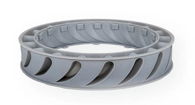

ABS-like Gray (Accura Xtreme Gray)
ABS-Like Gray is a widely used, all-purpose material that provides flexibility relative to other SLA resins.
![Sample of ABS-like Gray (Accura Xtreme Gray)](/media/hu3hwj5o/3dp-materials-tool_images_abs-like-gray-accura-xtreme-gray.jpg?width=670&height=360&rnd=133605039062870000)
Product Description
ABS-Like Gray is a widely used, all-purpose material that provides flexibility relative to other SLA resins. It is an ideal stereolithography material for durability and heat tolerance. Parts built with ABS-Like Gray will have a look and feel similar to a molded plastic.
Applications
ABS-Like Gray’s well-rounded mechanical properties make it suitable for form-and-fit prototypes, snap-fit assemblies, consumer electronic components, and medical device prototypes.
Tolerances
For well-designed parts, tolerances in the X/Y dimension of ±0.002 in. (0.05mm) for the first inch plus ±0.001 in./in., and Z-dimension tolerances of ±0.005 in. (0.127mm) for the first inch plus ±0.001 in./in. (0.001mm/mm), can typically be achieved. Note that tolerances may change depending on part geometry.
